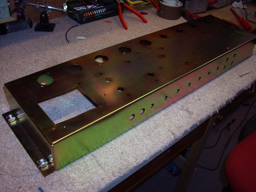

Finally going to the workbench again! :D
Im waiting on the parts from Metro, but today I recieved the very beautiful boards from BrianH !! :)
I also have some mustards and a 100pF RS cap.

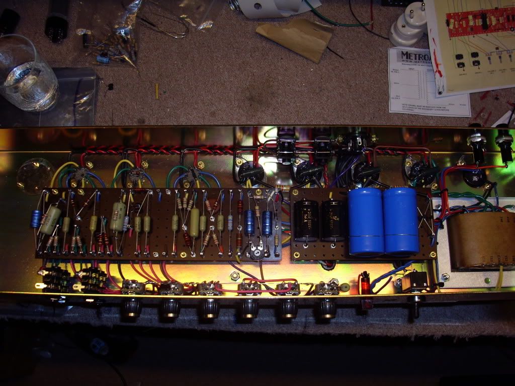

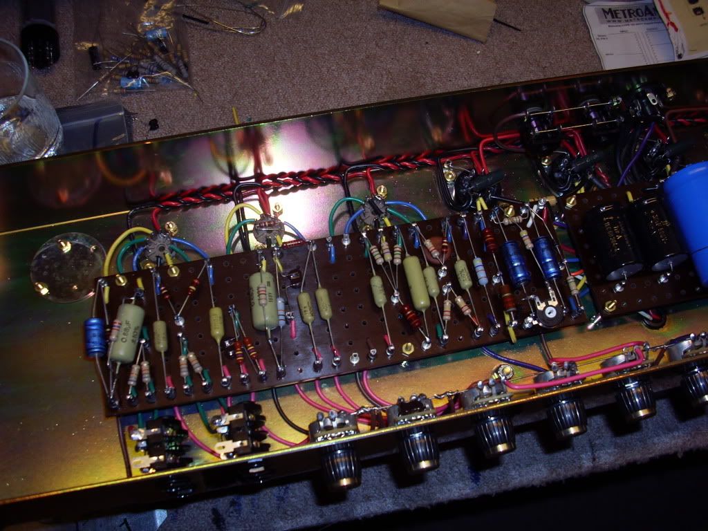

Almost done, waiting for the 3PDT standby switch and a few other parts!

Excellent work, Vegard! I have some 470pF RS silver micas to sell if you're interested, for the tone stack and mixer resistor.
Re: 12-series project
Post by VelvetGeorge » Sat Jun 05, 2010 12:23 pm
Looks great Vegard!
One note: I think you have a 10k 2W MO in V2, that should be a 100k. It looks like brown-black-orange in the last pic. I'd suggest using Allen Bradley or a carbon film there personally.
Vegard
Posts: 250
Joined: Wed Oct 08, 2008 11:01 am
Location: Brumunddal, Norway
Post by Vegard » Sat Jun 05, 2010 1:25 pm
Thanks George!
Haha, you are absolutley right. Thanks for noticing! :D
