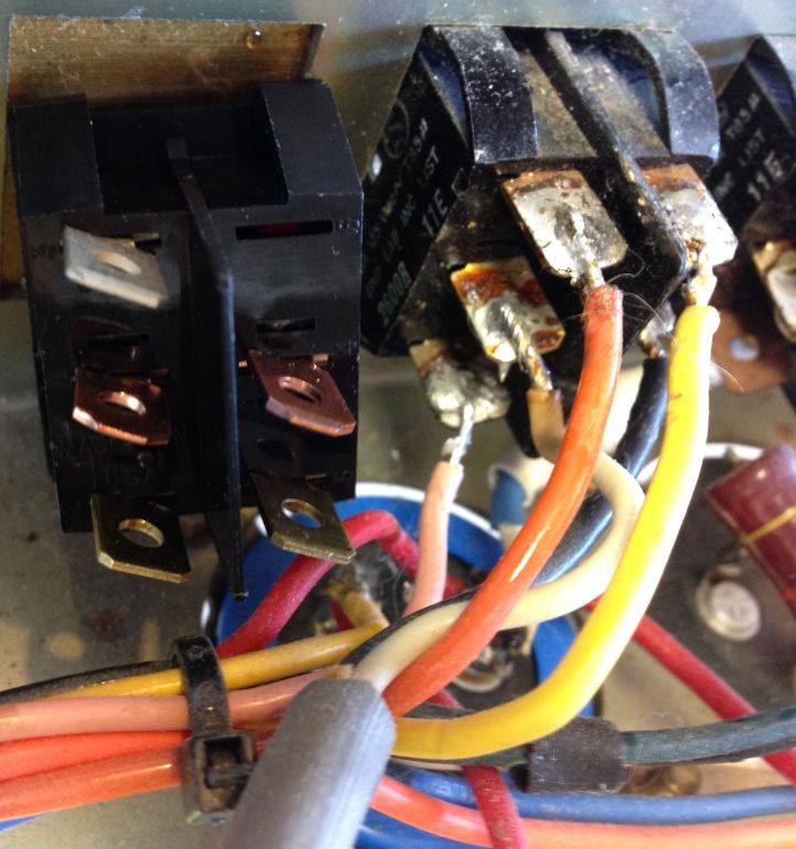

I am changing out the lighted power switch on my amp with a replacement from Mojotone.
The original power switch looking directly from the back facing the pins, has 5 pins, 3 on left side and 2 on the right (top and middle).
Orange ...... Yellow
White ...... Black
Pink ....... no pin
When I position the new power switch along side with the 3 pins on the left it has the 2 pins on the right but they are in the middle and bottom position of the switch.
Correct wiring is:
pink ..... no pin
white ...... Black
Orange ......Yellow
