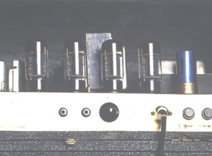

So here is a shot that leadguy posted on page 23 of the Debate on Ed's Plexi thread some time ago. It's a Germino Fillmore amp and the OT looks huge! What will this do to the amp?: add more head room, sag or that strange magnetic field Plexifield talks about.

lol...
I've got that pic among others on my desktop right now, and I've been searching all over the net comparing photos to the one I posted above. I talked to Brian and I'm ordering a 1202-132 tonight, because it seems to be the closest modern equivalent. The O.T. Germino is using in the Filmore is a M e r r e n Audio 1202-132. I'm ordering one of Brian's O.T.s.
You can even measure the width of the power tubes and then the core of the O.T. in the pic I posted and it's 3/4" vs 7/8" and the OT is further away in the shot. The Sylvanias measure 1 5/8" across; that O.T. is 2"; it has to be. IMHO, if Ed had regular sized EL34s in his amp, that OT would look as big as the one in the Filmore does. The fat bottles make it look more proportional.
EDIT: One more thing; if you look in the pic, it seems that the 2" Drake is wider from endbell to endbell than it is across it's center, which would necessitate rotating it 90 degrees in order to make space. Why would Ed drill more holes in his amp if he were just going to replace it with an O.T. that was the same dimensions as the one being replaced and didn't require being rotated to make more room? I'm of the opinion that everything in that amp is the way it is for a reason, whether it's the O.T. and it's size/orientation, the choice of caps, NFB setup etc. It's all part of a recipe.

We need to try this already. I'm still not sure how this will effect things. Won't a 2" make the amp really stiff? I attacked a width comparison with the tubes.

Interesting, when you zoom in like that, the widths look much closer....hmmmm, maybe I'm chasing rabbit trail here.Strat78 wrote:We need to try this already. I'm still not sure how this will effect things. Won't a 2" make the amp really stiff? I attacked a width comparison with the tubes.

Here's something else. While this was probably long after those pictures above were taken, the OT seems to have been rotated 90 degrees
Thoughts? I don't know if it's the same OT as we can't see the width.
