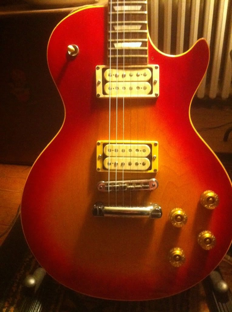

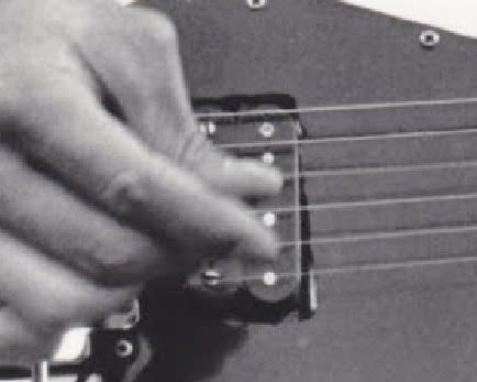

If this was a typical PAF in the sunburst strat shouldn't the PAF type bobbin holes also be visible at the top of the slug bobbin between the E and A strings? Considering the two lower bobbin holes are visible in this picture I think we would also be able to see bobbin holes at the top in this shot if they were there.
The typical PAF bobbin holes are visible in this shot at the top of the pickup, above the low E string on the screw bobbin and below the low E on the slug bobbin. It appears the pickup in the sunburst strat doesn't have those holes.
Here's a pickup that has features that match up very well with the one Ed had in his sunburst strat. Gibson T-tops. This is also at least somewhat consistent with Ed's statements about his high regard for Gibson PAF's.

TWANGGG is right there is no upper holes at the top of the coils and the T -tops did not have these.
So it could have been a T-top which is a 7.5K with a shorter bar alnicio 5 magnet.
These pu's are VERY LOW OUTPUT.
