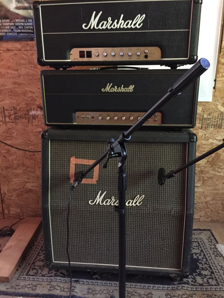

I've got two 57's on it! Both off axis on the right side of the speakers. One is just off center and 1 inch away, and the other is angled towards the top edge of the speaker, about 2 1/2 inches away from the grille. I'll send some pics in a bit! FYI the strat has a SD Custom '78 in the bridge and a vintage 6 hole trem.

I totally understand the fist position and mic almost centered. Thats one I like. Its a go to position for sure. I go straight in but the edge of the dust cap divides the center of mic face-so yeah like an inch from center.
But if I inderstand the 2nd one is pointing up from the inside area to the outter edge of the cone? Angled away from the center and outward? I have done this and its that extra hair and middy tone. From what I remember. I can see that workin good.

Here are the mic placements I had before I dismantled them and took the Rockstah and my 1981 2x12 with me to Nashville. The' 72 4x12 still stands at my New York studio and I miss it dearly lol

Tried this morning. Not so much the exact place on the cone but the distance. Close and then a more distant one blended in.. Definitly lends complexity to it all. Gonna be a while fiddlin but yeah its pickin up more OD textures fillin it out more. Actually sounds a bit more natural like standing in front and collecting it all with your ears from a distance with some super natural enhancement.

I'm glad to hear that someone finally got the swing of I'm the one rhythm correct! I've heard countless of people do it and they never get it right! Have you tried using one 57 straight and the other on off Axis on the same speaker?

I don't know if you know this but the problem with double miking is phase issues, what I do I record a staccato played chord and zoom in the waveform, do a tab to transient and see if the beginning of the waveform is even with both mics if not, I move the mic that's behind the most and match it to the other one. Once their the same you should be in phase. But first make sure you like the tone with one mic,then add the other putting it 45 degrees from the straight mic.Some people record both mics into one track,. I like to record them in separate tracks so I can have the option later to blend them.

Ahhh.... exactly as I did.
Record both mics on seperate tracks and then have the ability to fiddle with the mix of both in relation to each other.
Crazy how it turns out. I brought my 2nd mic back about a foot roughly and parallel to the outer cones angle-for trying to catch the more subdued middy part of the paper of the cone.
First mic is basically straight in on center pretty much up tight close.
When adding in the second mic its so much more "middy" and if not careful can get "cardboardy sounding".
Still experimenting but I never got that much mids by adding just a 2nd mic before. Mid range appearant boost is actually quite considerable. More than I ever thought possible.
On playback its fun to play with that mix with both mics panned over top of each other. Its like movin the slider on the mid frequency of an e.q. almost. Pretty fat then goin extreme quick.
Anyone out there fiddlin should try this. Its eye opening where mids can come from vs just tryin to dial in your amp. And shows possibilities of what can come from where in the whole process.
Maybe more to these mic positions than people realize. I tried alot of the up close of both and blending. Stumped me. But distance? That seems to yield some stuff.
