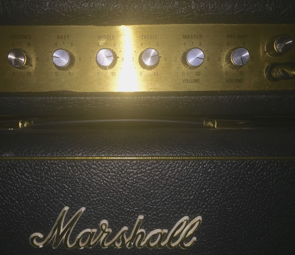

Thanks guys! The reverb has a high pass filter on it and light compression to bring out the presence of the 65ms predelay more. As far as the settings go, they are as follows: Presence: 9.5-10 (I believe it's at 10 even though it looks like 9 because the pot, when dimed, is actually rotated in the chassis to be at full when it appears to be at 9), Bass: 2, Mid: 7.9, Treble: 8.1, JMP Master: 8.5, Preamp Gain: 10 (to get that distorted fizz that my custom '78 usually smooths out at lower gain settings), PPIMV: 1.8-2. Here's a photo for better reference:
http://s1119.photobucket.com/user/Torqu ... j.jpg.html (for full image)
