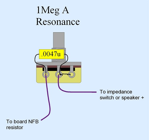

Those changes are not going to help the "punch" or lowend of the amp, best bet is some type of resonance circuit. Either fixed or variable on a pot will do. Also possibly 6CA7's instead of EL34's..

I had to add a fixed resonance cap to my 2204 build to get the extra low end I wanted. The right speakers will help alot also. What are you currently using?

fixed resonance with a 220k resistor and a 2n2 cap in parallel on the NFB line

Carbia wrote:fixed resonance with a 220k resistor and a 2n2 cap in parallel on the NFB line
That's a good one. This goes between the connection of the speaker tap and the feedback resistor.
Alternatively you can use a 0.01uf cap instead of the 220k II 2n2 cap combination for a similar effect.

Forgive the hi-jack but can someone explain, without getting too technical, what the resonance circuit is/does and how it works? I see that it's part of the neg. feedback circuit so how does that effect the NFB and the presence?

The resonance control or circuit blocks the low frequencies in the feedback circuit, which means that they are not "fed back" to reduce the gain. As a result, the gain on those frequencies is "open loop", i.e. as if the feedback loop was not there, whereas the gain at the other frequencies is "closed loop", i.e. attentuated by the feedback circuit.
The presence does the same thing - only for high frequencies.
