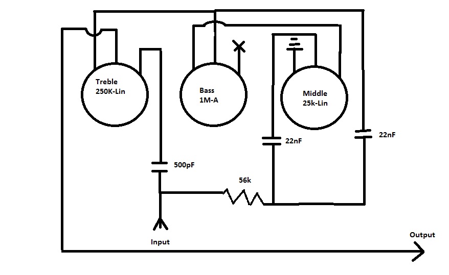

Hi everyone!
I just finished a Plexi SE build. Everything works fine except for the EQ section. As you can see from the schematic attached, it's a TMB-like EQ (bass, mids, highs). The treble is doing its work. The problem is that the bass pot is not working at all, and the mid pot is working strangely. When I turn up the mid pot it feels like it's bringing up not just the mids, but some bass too. When I turn it down completely, it almost mutes the amp..
Do you guys have any idea what it could be?
I'm attaching the layout i soldered.
Here's the schem:
ps: I've already tested the bass pot and the capacitors, they are ok!
Thanks in advance.

MODERATORS CAN CLOSE THIS TOPIC.
I was negligent when checking the capacitors. It was a bad one. Swapped it and there it is!!! My bad :roll:
