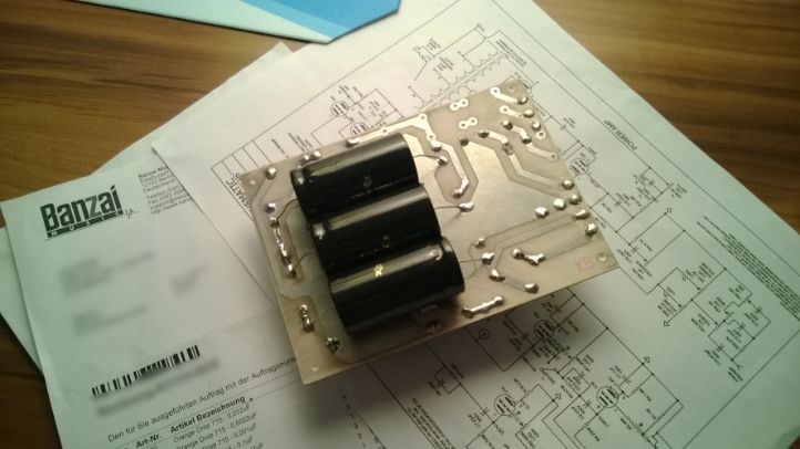

Hi, this is my project, clone SLO100
Aluminium chassis:
Making PCB board:
Aluminium chassis:
Making PCB board:

- Posts: 30
- Joined: Sat May 07, 2011 11:24 am
Re: Slo 100 clone
It is a nice project
And Power amp almost finished... It's realy hard to get right capacitors for this one... I could get only F&T,I hope that they are good as Malory.

- demonufo
- Posts: 3882
Re: Slo 100 clone
F&T's are fine.
Much better than that Sprague Atom...
So I like purple, okay!!!!!!
- Posts: 121
- Joined: Fri Jun 15, 2012 3:37 am
Re: Slo 100 clone
F+T is a fine piece of german engineering. Lot's of ampbuilders use them as a standard. Just as good as mallory i think.
Another good option is Vishay BC components. Those are the caps i'm gonna use in my SLO clone.

I wouldn't have bothered with axial period. I believe we provided a pcb negative over at sloclone for radials. Most modern radials will beat the pants of ant axial you will find. Soldano now uses radials as well for the Slo100

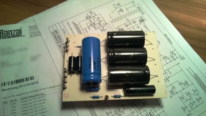

- Posts: 30
Re: Slo 100 clone
Most of the parts:
Working on chassis(Aluminium 2mm):

- Posts: 121
Re: Slo 100 clone
Thiez wrote:F+T is a fine piece of german engineering. Lot's of ampbuilders use them as a standard. Just as good as mallory i think.
I have a powersection board from the sloclone forums for radio caps. Now i wanted to use the Vishey BC components caps but they are 30mm diameter.... which woudn't fit the board cause 25mm is max.joey wrote:I wouldn't have bothered with axial period. I believe we provided a pcb negative over at sloclone for radials. Most modern radials will beat the pants of ant axial you will find. Soldano now uses radials as well for the Slo100
Also Roederstein, tube amp doctor, old philips, F&T etc that i could find are all +30mm diameter. You know what brand of radials will fit the PCB Joey?
- joey
- Posts: 982
- Joined: Thu Aug 20, 2009 10:40 pm
- Location: Allston, Massachusetts
Re: Slo 100 clone
Which one? the ones Smash sells?Thiez wrote:Thiez wrote:F+T is a fine piece of german engineering. Lot's of ampbuilders use them as a standard. Just as good as mallory i think.
Another good option is Vishay BC components. Those are the caps i'm gonna use in my SLO clone.I have a powersection board from the sloclone forums for radio caps. Now i wanted to use the Vishey BC components caps but they are 30mm diameter.... which woudn't fit the board cause 25mm is max.joey wrote:I wouldn't have bothered with axial period. I believe we provided a pcb negative over at sloclone for radials. Most modern radials will beat the pants of ant axial you will find. Soldano now uses radials as well for the Slo100
- Posts: 121
Re: Slo 100 clone
Sorry for the topic hijack...
Yes the on with optional elevated heater mod. For now i found two caps that will fit. Thats samwha and nichicon.
I dont like samwha, cause they have a lot of faillure in the samsung products. Nichicon is a bit split if i read the reviews on the internet. Some people say they are fine, some say they have quality probs.

- demonufo
- Posts: 3882
Re: Slo 100 clone
I find the better spec'd Nichicons to perform REALLY well, and test superbly. I can't speak for the longevity of them though, but I've not had one come back yet...
