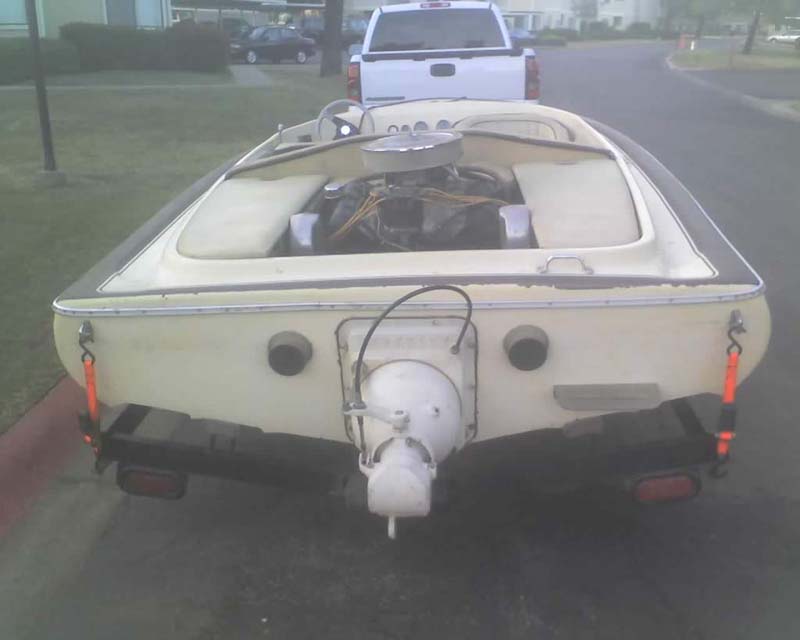

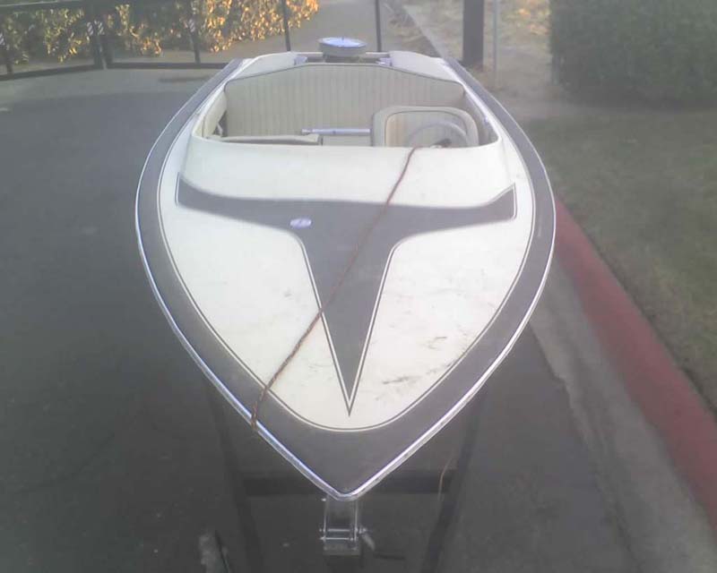

So after that happened I decided to take some time off and finish the jet boat I was rebuilding from last winter, which I finally finished and got on the water. So far I've had her up to 62mph...she's loud and proud...just like my Marshalls. Aside from a Marshall cranked to 11...there's just nothing that sounds better than a Chevrolet 454 with open Bassett headers. Flames I'm sure you'll agree with me on this one. ;D

No but they damn sure got that beef!!!Flames1950 wrote:Modern OHV V8's just don't have the upper end character of the oldies.Flames I'm sure you'll agree with me on this one.
Just for Flames, here's the specs on the motor:
Motor came out of an RV with only 30,000 miles on it, never been overhauled
Mark IV 454 punched .030" over 2-bolt main block
Stock crank and rods
TRW L2465F Pistons (9.6:1 comp ratio w/ 120cc combustion chambers)
Large oval port heads (casting #353049)
Heads were machined for bigger valves (2.19" intake/1.88" exhaust SS valves)
Plasma moly rings
Iskendarian 280H Mega Hydraulic flat tappet single profile cam -
280 seat - seat/232 .050" duration
.549 lift (w/1.7 rocker ratio)
60* seat - seat overlap/12* .050" overlap
110 lobe center
Isky Super Lifters (anti pump up type)
Comp Cams 1 piece 3/8 pushrods
Scorpion 1.7 roller rockers
Double valve springs w/damper (135lbs seat pressure/395lbs open pressure)
Comp Cams double roller timing chain
Clevitte 77 main/rod/cam bearings
Melling 77G oil pump
Edelbrock RPM Air Gap intake manifold
Holley 4150 Marine 750cfm double pumper carb
MSD Ready to Run distributor, 6M-2 box and Blaster 2 high vibration coil
In theory I'm thinkin' close to 500HP/500 ft lbs of torque. The cam is set up specifically for a jet boat...the ramps on the lobes are steeper and the HP peaks out at about 5500 RPM, while the torque peaks out at 4500 RPM.
