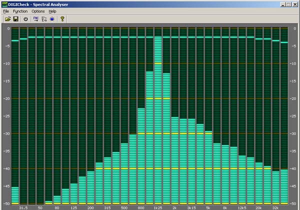

I'm sweping some test tones through various components-
mustards, Sozos, Mallorys ect
and I would like to save the response curve, but my spectrum analyizer is real time only. I figure a screen shot will do the trick. But I have no idea how to make one.
Little help here???? I'll share what I find out about frequency response....

Post by VelvetGeorge » Fri Jan 13, 2006 7:57 pm
Test post....
VG
(59.11 KiB) Downloaded 770 times
Post by VelvetGeorge » Fri Jan 13, 2006 8:01 pm
That last one was the Sozo .1
this is the Philips .1
Dead on from 40-40k. This graph is .5db resolution.
George
(60.42 KiB) Downloaded 767 times
