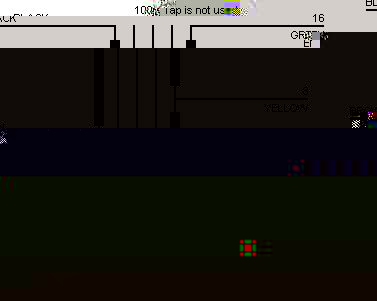

Something struck me. Are the wires to the OT primary correct.
Not just a correct centre tap with reversed outer coils, I mean the centre tap hooked to a pin 3 and one of the outers as a centre tap etc?
Just a thought........................

the centre tap goes of the impeance selector goes to the hot side of the output jacks, the 4,8,16 ohms wires of the OT go to their respective lugs ( verified with Brian with voltages ) , the black wire goes to pin 3 of V6, the red wire goes to the pin 3 of V5, the orange wire ( 0 ) goes to the ground side of the output jacks, and the brown wire goes to the preamp turret with the choke, linked to the mains filter caps.
So you think that the orange, brown, red and black wires could be mixed up ? i'm not sure how to verify it. But we checked the OT, in my previous posts, at least the 4,8,16 ohm taps + output of the impedance selector.

No the COMMON of the secondary goes to the jacks (ie the end of the winding), the coloured taps to the selector (the 16ohm being the end of the winding)
The primaries are the black/brown/red. I know that different Drake trannies used different colour codes. As you obviously have a weird problem I am just going through the wierd possibilities. On this trannie the brown should be the centre tap and goes to the choke/HT feed. The other two wires go to the plates, if you get the outers swapped over you get positive feedback and a scream but imagine if the black was incorrectly wound as centre tap and you had HT going to one end of the primary, it might give the symptoms you describe - like a single ended amp very asymetric in the extreme you would still get the roughly correct plate voltages (if as you say everything else that can be checked and double checked is correct).
I would unhook them and put a meter across each pair of wires so that you can determine which is the centre tap. If I am wrong you can curse me - just trying to think outside normal wierdness!!

Isn't it what i explained ? Sorry then. Yes, this is the common of the secondary ( orange - 0 - ) which goes , on my amp, to the ground side of the output jacks.
i meant : the output of the impedance selector ( not the center tap, though it's the center lug ) goes to the hot side of the output jacks.
yes, this is the case on my amp.
what "HT" abreviation means again ?
We can verify it if it's a potential "out of the normal wierdness", though it looks good. Ok, just to be sure.
so what should i measure with the meter, to determine which wire is the center tap ( supposed to be the brown one ) ? accross which wires ? ohms ? voltage ?
You're talking about the black wire from the primary that would have a wrong color, and swapped with the orange one ?

without the output tubes in put an ohm meter across each wire of the primary. Two readings will be roughly the same the wire that is in the middle will be the centre tap.
ie on a 50 watter 45 ohms between white and red, 47 ohms between red and brown, 92 ohms between white and brown means that the red would be the centre tap.
Your readings will be different but the principles are the same.

Well : i put the meter accross black and brown of the primary, black and red of the primary, red and black of the primary ? is it what you're saying ? ok.
i measured also the secondarys on the spare OT. about 1 ohm between the orange ( common ) and the green. arround 7-8 ohms accross the orange and blue, and about 5,5 ohms accross the orange and yellow.
Xplorer
Posts: 2480
Re: JTM 45/100 - Build story
Post by Xplorer » Thu Oct 25, 2012 7:47 am
on the spare OT :
88,3 ohms accross the red anc black.
41,2 accross the black and brown
47,2 accross the brown and red
Xplorer
Posts: 2480
Post by Xplorer » Thu Oct 25, 2012 7:50 am
on the amp :
89,7 ohms accross the red and black,
42 ohms accross the black and brown,
48 ohms accross the red and brown
Xplorer
Posts: 2480
Post by Xplorer » Thu Oct 25, 2012 7:51 am
The brown in every case seems to be the center tap as it should, and it is connected to a turret where one choke wire is going too, and both are connected to the mains filter caps.
