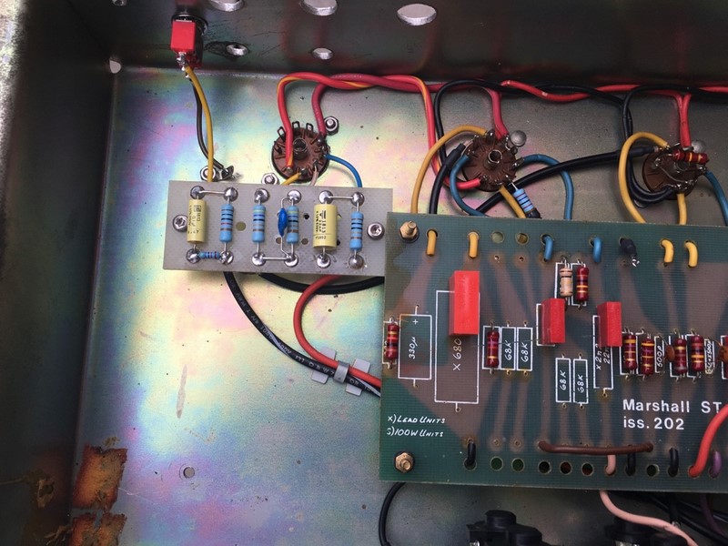

Recently I've accomplished a Marshall mod for a customer in the USA
After reading the description you may imagine, on what this mod is based :D
Check it out:
https://www.facebook.com/permalink.php? ... &__tn__=-R

Larry,
I'm guessing the mod is 99% close to what's been debated here in the thread.
What's clearly different is how you arranged the board and cleaned up lead dress...something that's a major ingredient to your amps.

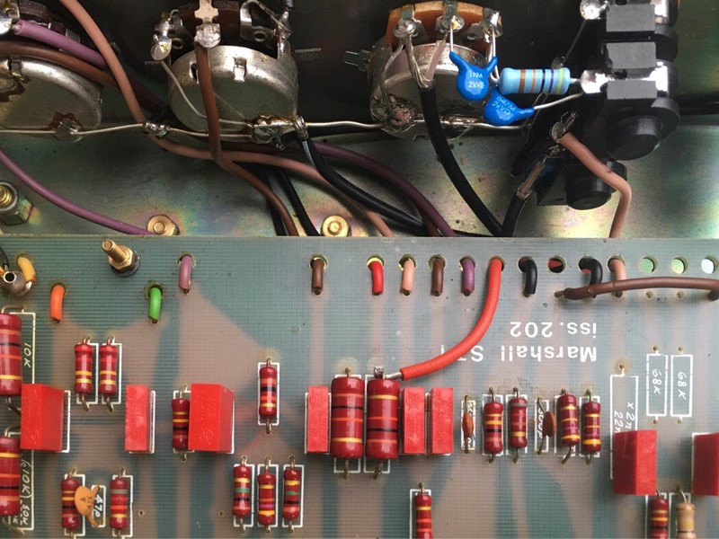

Larry, have you used any of the Dino heritage in this amp? I believe I hear some ceramic caps affecting the upper mids but those ceramic caps may be stock as well.

Larry, I'm guessing the mod is 99% close to what's been debated here in the thread.
S.I.R. #39 mod, altogether 12 components, 2 components w/ another value = 83% :D
input grid stopper = 18K instead of 68K (remarkable hiss reduction)
the SIR voltage divider 470K || 470p / 220K changed to 470K || 470p / 470K

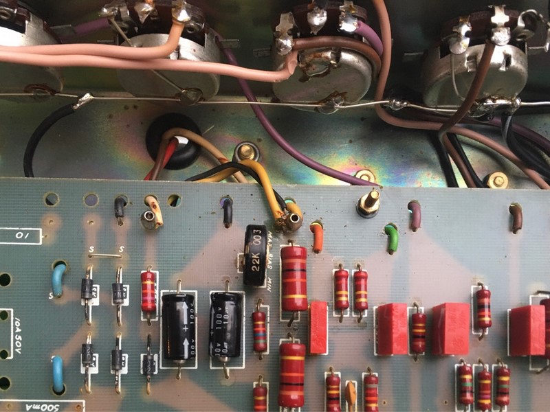

wdelaney72 wrote:
Thu Jan 16, 2020 10:40 am
I've first accomplished the mod, so I've had a before/after cleaning the lead dress - a remarkable difference
Very important: Have an eye to the violet lead to the Presence pot and keep it away from the tone control leads AND from the OT's primaries :wink:

I will ask....did you go DC or elevated heaters on pre-amp?
Neither, nor - I even kept the heater's CT at its orig. spot next to the PT

CoffeeTones wrote:
Thu Jan 16, 2020 11:01 am
I believe I hear some ceramic caps affecting the upper mids...
My photos have answered your question?

Post by CoffeeTones » Thu Jan 16, 2020 11:22 am
Sure :lol: Thanks Larry. We appreciate your sharing this with us. I see other, unseen things too! :scratch:
novosibir
Posts: 4654
Location: Nuernberg, Germany
Re: S.I.R. 100W SuperLead Schematic pt. II
Post by novosibir » Thu Jan 16, 2020 11:29 am
What else can you see, what maybe I didn't see?

Post by CoffeeTones » Thu Jan 16, 2020 11:47 am
Nothing you didn't see. I was speaking of the lead adjustments. Of coarse this is different in every amp, so no need to try and copy any lead dress.
