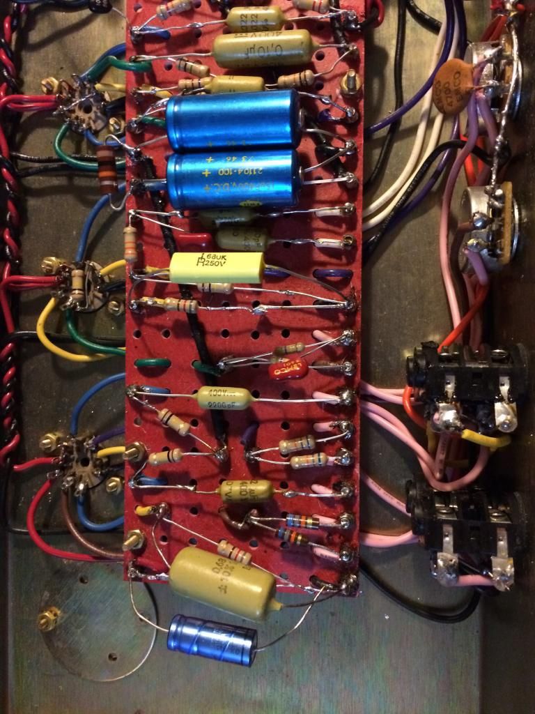

rgalpin
Posts: 3668
Joined: Mon Apr 04, 2005 10:08 am
Location: Washington, DC
Re: Variac a Super Lead instead of attenuating
Post by rgalpin » Sat Jan 10, 2015 8:59 pm
da guts
Jeremy1283
Posts: 384
Joined: Fri Aug 01, 2014 6:16 pm
Location: Los Angeles California
Post by Jeremy1283 » Sat Jan 10, 2015 9:22 pm
Im perplexed as to why you can dimed your amp and i cant. :scratch:
Jeremy1283
Posts: 384
rgalpin wrote:da guts
Same spec i have.
Hmmm.
rgalpin
Posts: 3668
Post by rgalpin » Sat Jan 10, 2015 10:18 pm
EDIT:
do you have a grid resistor on v3 pin 2?
Jeremy1283
Posts: 384
Post by Jeremy1283 » Sat Jan 10, 2015 10:25 pm
Here is my current spec
100k on the nfb with a 4 ohm tap
rgalpin
Posts: 3668
Post by rgalpin » Sat Jan 10, 2015 10:32 pm
i have 32+32 filter cap in the pre amp. also - the grid resistor on v3.
