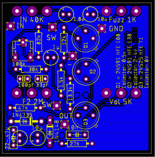

Made some progress on the schematic and PCB. its 5cm by 5cm to fit in a 1590B enclosure
Gonna order some pcb and component soon
PCB image:
Schematic image:
https://www.mediafire.com/convkey/ee40/ ... fwl36g.jpg
PCB image:
Schematic image:

Tek, it looks real exciting. Maybe I can get a couple of PCBs from you to finish the projects for Shakti and Xplorer--they've been waiting a long time for me to get some time to work on their units and are probably about to give up on me.
Just a note on using the zener to get DC feedback; I had to fiddle around with a few, and think I ended up with the zener and a regular rectifier diode in series to get the perfect voltage drop. You know it's real fussy and responds only within the range of voltages I listed on the schematic.
I may be able to find some NOS 2N591s for you to use........
