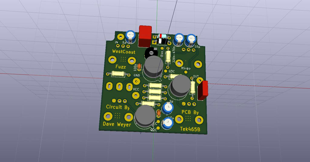

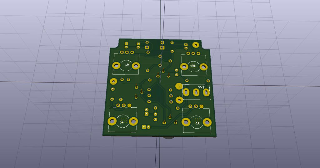

Ok, so order placed for 40 more boards :O.
New board rev changes are
- BLACK solder mask
- milled top corners
- PCB mounted pots and wild switch(you can use a on-on OR on-off-on switch to disconnect the FB, you can also omit the wild switch and place a wire jumper instead)
- moved test point to the top layer
- removed the pad for the always on bypass switch(can be hardwire into the pcb if needed)
- Added pad to parallel 1u/820n input cap for 1.8u
- everything else is the same

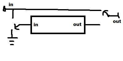

Just a few more observations;
- the "always on" feature can actually be very useful. However, there is one thing that prevents it from working well in its current setup; in off mode, only the In and Volume controls are working. I prefer to set the In (input impedance) control just raised a notch or two to allow wahs to work properly and to not have the Off mode sound very muffled. But the problem is that to get it even to unity level the volume has to be set very high, and this adds a lot of hiss.
HOWEVER, if I then switch it to ON mode, the gain control comes into play. With gain on 0, it is essentially the same as the OFF sound. But raising the gain control just a little bit adds more gain and beef to the sound, to where it starts to sound like that "mysterious boost" Dave talked about. So IMHO, for the "always on" feature to be really useful, the gain control would have to be part of it, at least at a low level.
Then enter the "wild" switch, where the gain control enters the next level, so to speak. If this fuzz could have two footswitches, it could be the ultimate killer fuzz;
- one footswitch for true bypass on/off
- one footswitch to switch between low level gain and "wild mode" gain.
This should be easy enough to achieve, shouldn't it?
Another option would be to have a toggle for true bypass or "always on", with the footswitch always going to wild mode.
- Posts: 210
- Joined: Sat Jan 10, 2015 9:43 am
I agree with you, this is exactly what i am thinking.
1. If you wire for true bypass you probably want to do it like the drawing below(or add a 1Meg to the input)
2. You can run the wires(and 1Meg resistor) from the wild mode toggle switch to the stomp switch.
last option. You can move the always-on switch wire to the now unused toggle switch.
That was easy(except the drawing part lol)
