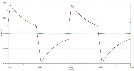

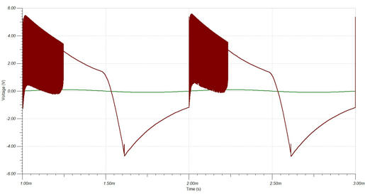

I think ive found some way to quiet the fuzz(when the gain i turned up).
The 3 capacitor in the feedback network are doing some king of phase shiftinf of the NFB.
Removing the 100p may reduce alot of noise when the gain is turned up.
I did not try it yet in real world but i did some simulation this is what i get:
First this is whit controls maxed out(except for the input impedance control) and a 20k source 1khz 100mV peak signal:
Now if we turn up the inpedance more by turning the 40k input pot to 50% it get worst(because we let more of the NFB shifted to almost PFB getting in):

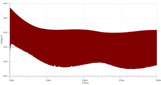

Now if we remove the 100p with the same setting as above we get that:
let me know what your thinking, i will try to fire up my amp(wich was not firex up for 6 month) to test it when spirit kick in.

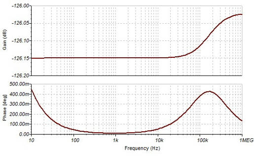

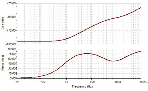

Here we can see the phase angle of the NFB network's Current(with the gain maxed out, current and not voltage phase because Q1 is a current amplifier)..
First with the 100p, almost 90 degree shift as the Strength of the FeecBack increase:
Next without the 100p(barely 0.5 degree shift and go back down to 0 as the strength of the FeedBack increase):
So long story short.
hypothetical:
if you have 1 mA at 0 degree input(interferences or whatever)
and you add a NFB of 1 mA at 180 degree you end up with 0 mA at 0 degree(you cancelled it out).
Now if we have 1 mA at 0 degree and add 1 mA at (180 + 80 degree) = 260 degree. or (180 - 80) 100 degree.
we get 1.28 mA at -/+50 degree. so we are adding the noise and not removing it and maby we have an oscillator, thus the ringing in the above post(its probably well above 10kHz)
So when the gain is down your shorting the 100p and reducing the impedance of the NFB network so the collector of Q3 start to act as a current source.(this is why this dont happen with a capacitor accross C and B.)
When you turn the gain pot up it increase the impedance of the NFB network, and now Q3C start to act as a voltage source. this is where all the shifting start to happen.
With the 100p removed the 2Mmaxxed pot turn the input of Q1 from a current amplifier to a voltage amplifier to the NFB network, cancelling the phase shift.
This is the best i can explain it to myself.
Maby somebody else can teach us

First of all; sorry to hear about your ear trouble. Tinnitus sucks, but it sounds like you have much worse issues to deal with...
I like your mindset about this, but the tech stuff is infortunately way over my head. Someone else will have to chime in. The fuzz is a touch noisy, but not really worse than a standard fuzzface. Certainly not when you factor in the amount of gain available.
- Posts: 713
Well Tek, thanks for joining in. Always a pleasure to have your analysis. I am sure all of us here are sending thoughts and prayers for your hearing problems, I sure am.
If you happen to read my earlier posts on the fuzz, you will find a caveat regarding the possibility of it becoming an oscillator at high frequencies. The premise is rather simple: if there is sufficient gain at a frequency where there is 180 degree phase shift, then the negative feedback becomes positive feedback, and you have an oscillator. That's how oscillators work, in this case phase shift oscillators. The actual feedback signal is in phase with the input signal.
I you have a Marshall with tremelo, you can see it in the circuit; it is an amp, with three RC networks (resistors and capacitors in series from the output fed back to the input). Each RC network has 60 degrees of phase shift at the frequency of the tremelo, causing the feedback signal to be in phase with the input. Think of the three transistors in the fuzz circuit as RC networks, each with a phase shift of 60 degrees at say 25 KHZ. If there is gain in the circuit at 25KHZ there will be an HF oscillation, just like Tek showed in his simulations.
All this depends on the transistors you use, circuit wiring, proximity to ground planes, and so on.
Amps with three poles (three amps with gain) are notoriously tricky to use with negative feedback.
I tried to warn builders of the circuit that they may have to tweak the feedback caps or adjust the overall frequency response so that there is less gain at high frequencies. I had to. A HF oscillation can sound like noise in the circuit.
Either limit the frequency response of the circuit, or lessen the negative feedback at high frequencies. As Tek showed, one way is to remove the 100pf cap. (You end up with a lot of high frequency gain without the cap.)
You can also experiment with different value caps or or types of caps, and different value feedback resistors.
I tried to get enough negative feedback around the loop to get a unity gain amp out of the thing when the gain was set to minimum, or close. But I do remember having to tweak it, in keeping with the transistors I used.
