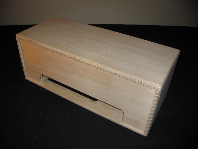

You don't have to completely gut the Bogen circuit and rebuild another preamp design if you don't want to---- i traded a CHB35A to a friend recently for some wooden amp head cases he and his dad build--
I had them build these JMP-ish head cabs to fit the CHB-series Bogen chassis as well as the Hammond 16x8x2" chassis.
This CHB35A has all new filter caps, modded screen grid supply, and a modded but stock Bogen preamp--- two vol controls (each running 1/2 of V1---- different tone set-ups on each one)--- running into the stock Bogen Master Vol (not the greatest set-up for guitar -- but it works)--- i modded the bias circuit to make it adjustable (new bias cap, also) and it's running EH 7868 output tubes.
People seem to like the tone of this one but i like the "Plexi" Bogens better..............gldtp99
