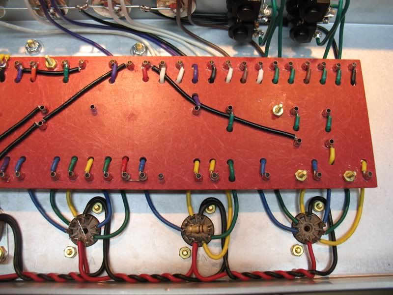

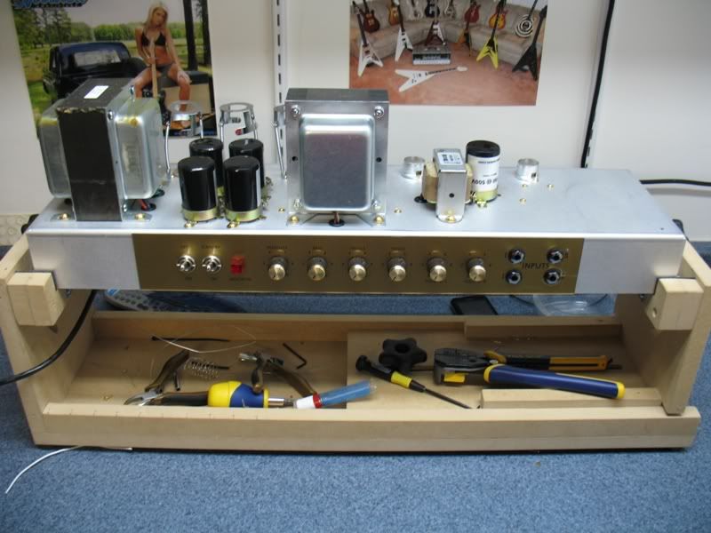

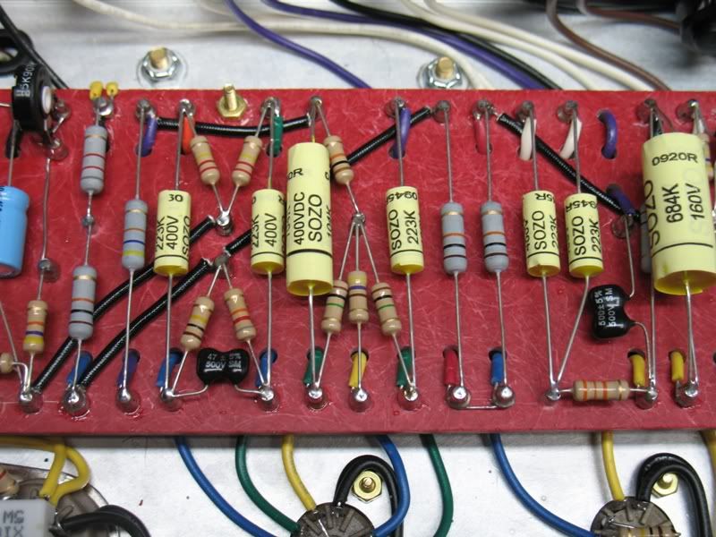

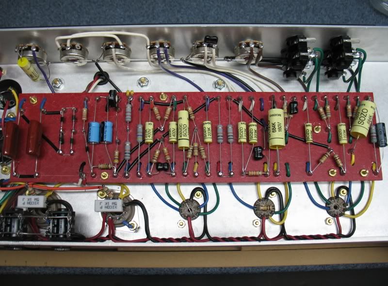

Band practice cancelled; more time to work on my amp. Here's where I stand...

Congratulations!
looks nice and clean. Hope everything works out perfect!

It looks good. Good job Mad-"Axeman"

Great job, Stu! You sure didn't waste time populating that board! :D Very nice wiring, shiny solder points n all. Testing should go well. Take your time. For peace of mind, always leave a load attached when you fire up. And don't forget to double check when testing calls for AC or DC readings.

Just wanted to mention the wire strippers i bought for this project- they worked great!
