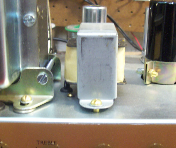

Here's a couple pics. I was surprized to find the choke was not bolted down competely on one side.

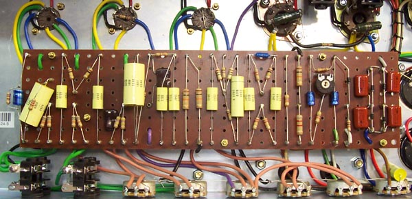

Also a pic of the board.

Post by VelvetGeorge » Mon May 08, 2006 8:28 pm
Tweaking ROUND 1
Here's the next clip. Here I have:
replaced the stock signal and presence caps with Sozo Vintage +
shortened and rerouted wires for less noise and no squeal
tightened down the choke mounting bolt.
No break in or anything. Just fired it up and hit record.
I also checked the B+. With exactly 120VAC coming in I have 470 on the plates of the outputs.
HW w Sozo_01.mp3
(1.28 MiB) Downloaded 7594 times
Post by VelvetGeorge » Mon May 08, 2006 8:29 pm
Here's a pic:
VG
board with Sozo caps.jpg (76.46 KiB) Viewed 91381 times
