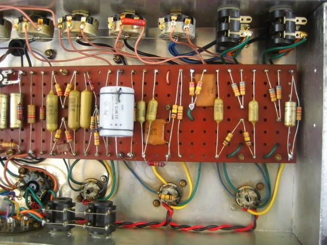

Taking my time. Now it's gonna be a tricky part with all the wires, under and over the board ...
if i remember correctly, some on V1 ( green and blue wires x 2 ) should be away from each other as much as possible, to avoid noises.

Yes.Xplorer wrote:Taking my time. Now it's gonna be a tricky part with all the wires, under and over the board ...
You loop the green grid wires (from both the 68k pairs and 270k) up through the board (look on amp archives etc) allow the wires to stay in the air to the socket.
The blue plate wires go straight down from the turret to the chassis floor and along the chassis to the socket.
The yellow cathode wires not so crucial but make sure they cross the heaters at 90 degrees.

Adrien, the populated board looks really great! Nice job! It's really a great feeling when this all comes together and the result really even nails the looks of originals. Can't wait the finished amp and some clips!

Thanks for the nice compliments and advices !
Karlis, your amp isn't bad too
Today's progress shots : i started to solder the ground wires from the pots to the board, plus a few others. Then i took care of the pink wires and .... No more solder tin left ! i have to buy some when i can.
