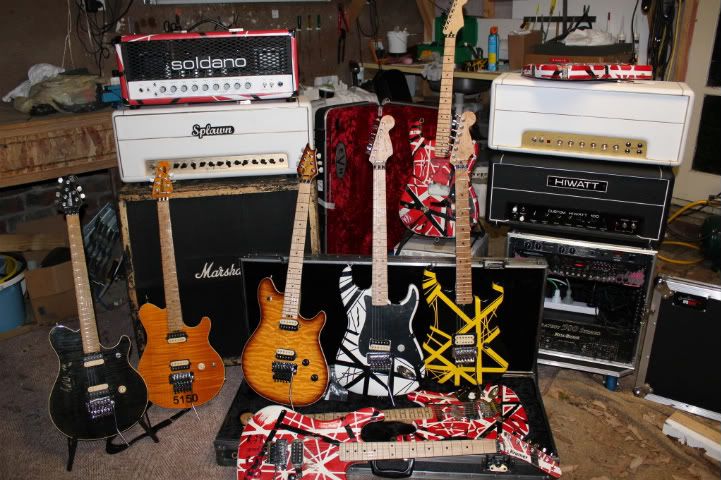

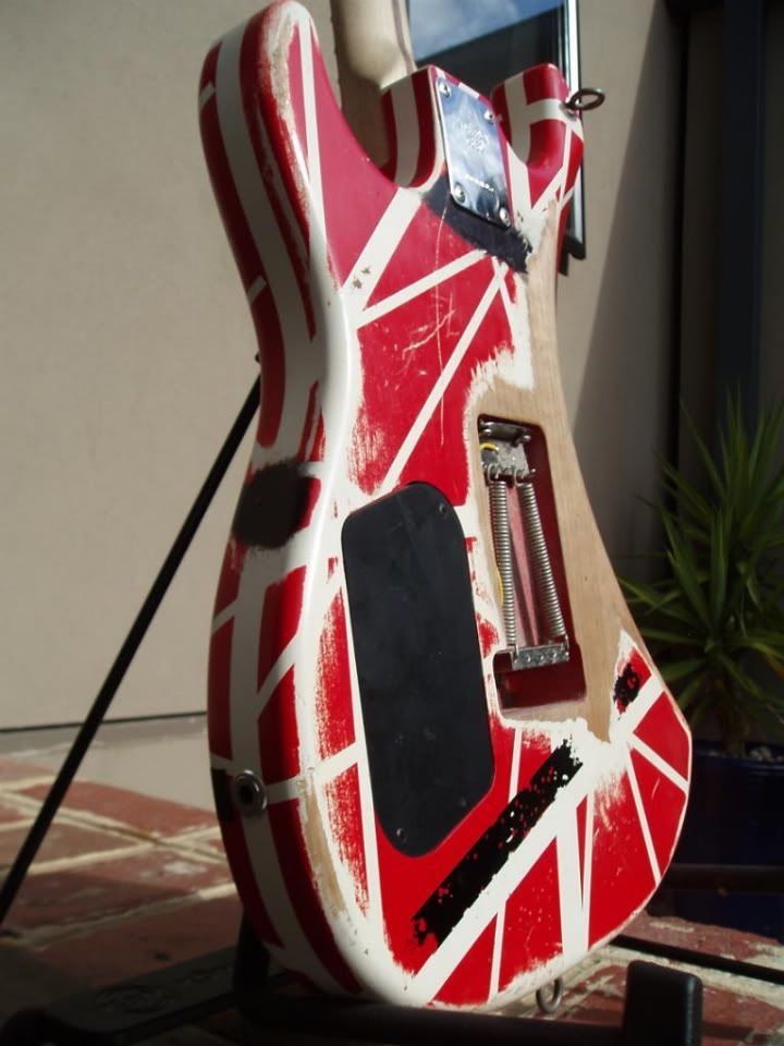

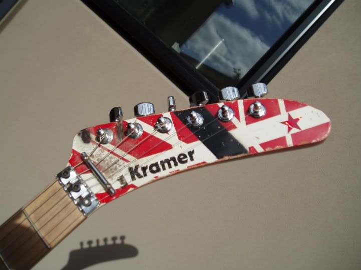

Excellent stuff flex5150! You know I love the "5150"...I just got my dream neck from Musikraft for my old Kramer Striker 100ST and I am really excited...What are the specs on your "5150"? Where were the parts sourced,pickup, etc.?
Is that a real Fender Frankenstrat in the case?

Right on Garb the 5150 is the grail for me and damn if it isnt the hardest to replicate, that paint you guys use is diff to ours its way hard to get the wear authentic on the horns where the grey tape was.
Its a KNE Alder body (looking at the no bozo pics the grain suggests ash but I like alder) with a heap of sanding around the upper horn to round it out , and a MK neck off the bay 1/5/8 nut mod C med jumbos 6105.
Pup is a 78 duncan, Old school 80's FR (i have about 10 old school "made in germany" 1 liners if anyone needs one)( Made in W Germany M6 minis) people say Gotohs but I have another 4 sets of these laying around so I'll use them.
This week Ill be putting the worn lacquer on the neck I drilled out the holes in the heal today.
Its a real head F#@k doing the body .Use enamel paint and put the tape on it while its only tack dry will help the relic finish
Good luck if you do one Bro. post the pics up.

No the franky is my "Complete boot leg" I had the case made and ripped off all the candy too from Hi res copies. Its not for sale just for my self satisfaction that I could put the whole thing together for about $3000. Just got to paint the VH on the case then its finished.
BTW I have anoth 4 anvil logos if anyone is a stupidly obsessed as me.
