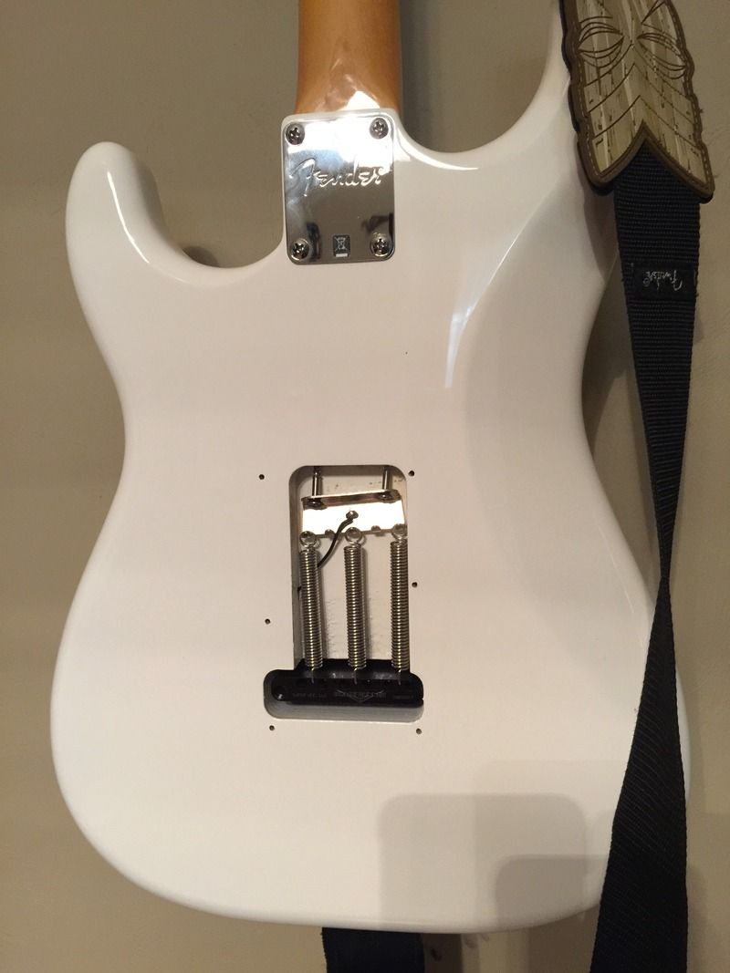

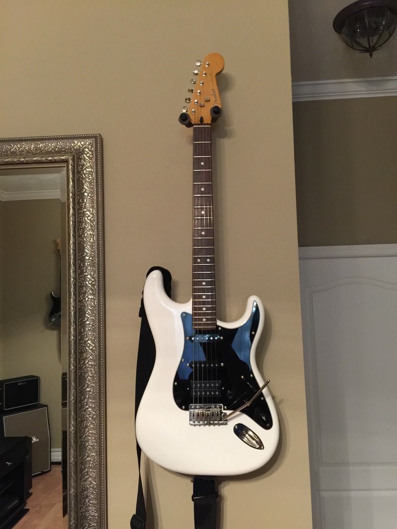

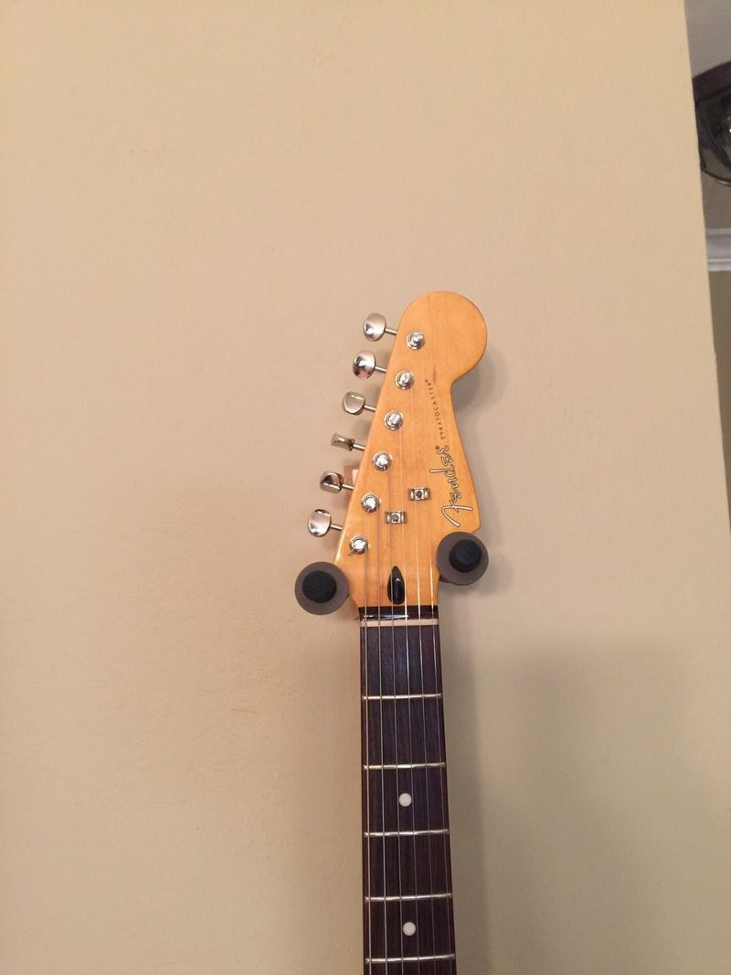

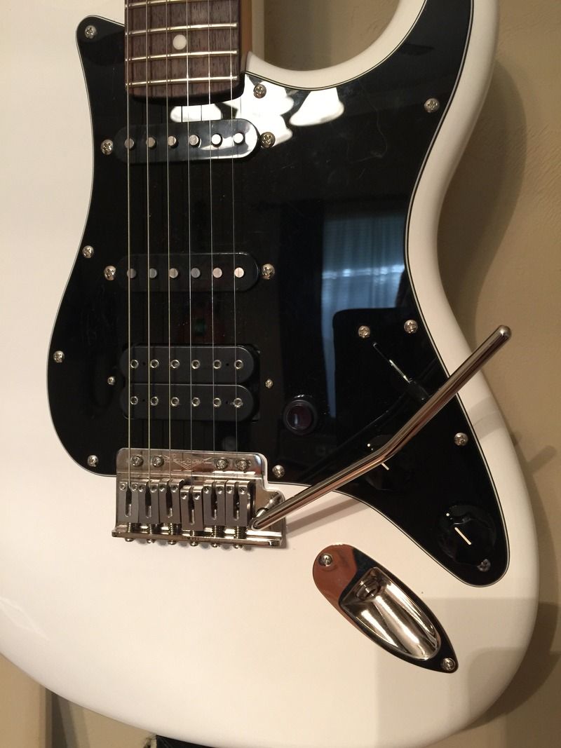

I have a strat setup like this and it's very good. Locking vintage tuners, tusq nut and bladerunner setup to float. It stays in tune almost as well as a double locking Floyd.dirtycooter wrote:I think some new life needs breathed into the trem market. Some more innovation.

The bar itself feels Floyd-ish, but with zero slop. The trem action makes Floyds feel inferior - it feels like there is a super tight connection to the guitar. There is also more acoustic resonance.
That being said, the Fender six screw still sounds the best to me, but I'm done playing those games. The bladerunner lets me bend, dive and pull up and comes right back in tune. Does great flutters too.
